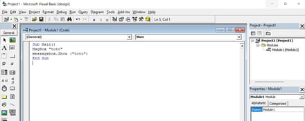

Msgbox imageformat
MessageBox.Show(imageformat)
